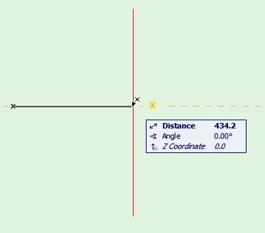

The perpendicular cursor does not show if it is over-ruled by another cursor type.
For example the centre node of an edge if that happens to coincide with perpendicular or the intersection of a guideline and what you want to go perpendicular to.
The attached image is perpendicular but the intersection of the guideline over-rules the cursor icon.
