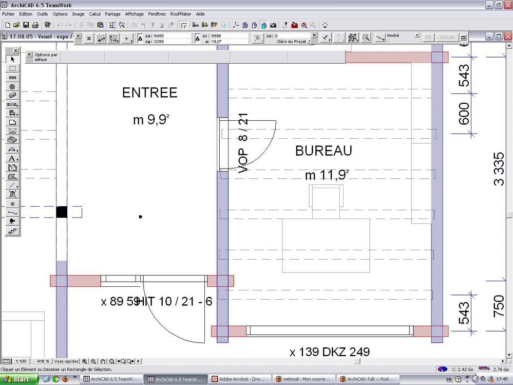

I don't know the reason, but now when I open any Archicad drawing, there is inversion in texts (normal text, surface text, windows text ...)
Here is a snapshot of my screen, attached to this message
You can see for example :
"entree m9.9²" instead of "entree 9.9m²"
"x139 DKZ 249" instead of "DKZ 139x249"
Does someone knows why ?
How can I turn it back to normal ?
Switch off the support for the languages that are written from right to left (Arabic, Hebrew ...)

Hello Djordje,
Thank you very much for your answer !
You were right, it was this !!!
Now, it's all fine
