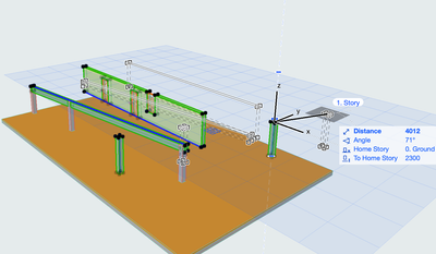

Dear Archicad Friends,
I wanted to ask, do you have the same issue when selecting elements in 3D. Let's say I select different elements (doors, windows, etc). When I hold shift and click from one element to another, to select those which I want, in 99,99% of cases Archicad will activate the cmd+D/move function for a whole group of elements... it is, to say the least, A VERY FRUSTRATING thing. Never happened on Windows and Intel Mac.

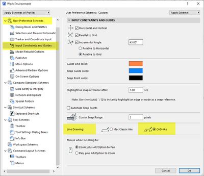

I would suggest that as you are Shift+clicking to select extra elements, you are slightly moving your cursor.
This will invoke the drag you are experiencing.
When you are SHIFT+clicking rapidly, it is very easy to slightly move you mouse as you click.
Also in your Work Environment make sure you have 'CAD like' mouse clicking turned on.
This way if you let go of the mouse button, the elements don't automatically just move (you have to click again).
This gives you the opportunity to right click and cancel the move and continue SHIFT clicking to pick more elements.
This is with a regular button mouse, I'm not sure how those funny Mac mice with no buttons work.
Karol Argasinski
Hi Barry,
Thank you for vital input, as always. I will try that.
The main reason of my struggle is that this is strictly the same app and during working on Windows I do not see any issues regarding UX/UI. Here there are plenty.

David Shorter
@Karol Argasinski Its a bug. If you have a whole bunch of elements selected in the 3D window and then try and deselect individual items Archicad tries to move all the selected.

David Shorter
I have reported this as a bug
however
IF you are very careful NOT to move the cursor then about 50% of the times you can delete the element
but it is much too sensitive and to make it work you have to slow down
IF you click the element and NOT a node deselection works fine
