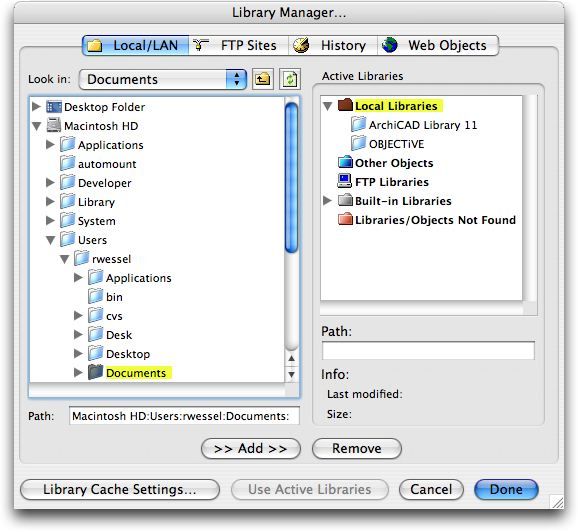

I moved all my current and archived projects (along with project specific libraries) and office libraries over to the mac's "Documents" folder, but when I try to open up an old project in AC9, the Library Manager won't let me direct it to the "Documents" folder. Question is, how do I need to set up my libraries, PLN files, etc. to be accessed from the Library Manager?
Dale,
The Documents folder is your documents, as opposed to other users. The place to look is in your home folder in the 'Users' folder. On my laptop, I find the Documents at 'Macintosh HD/Users/rwessel/Documents' (see image).
