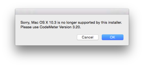

The CodeMeter driver bundled with ARCHICAD 16-18 cannot be installed on OS X 10.10.3
Affected versions: 18 and older| Severity: workaround applicable The CodeMeter driver included in ARCHICAD installers can't be installed. The installer recognizes 10.3 string from 10.10.3 as and older version of OS X, which is not compatible with the driver. The error message below is displayed when trying to install the driver:
Please note that the error message is erroneous therefore using this old driver version will not solve the issue. Instead the newest CodeMeter 5.21 driver solves the problem, which can be downloaded and installed manually from our Protection Key Driver Downloads page.

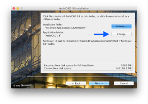

Browse function in installers
Affected versions: 18 , 17 | Severity: workaround applicable The browse function to customize the target folder for the installation will not open the file dialog. As a result GRAPHISOFT products can only be installed to the default locations on 10.10.
Workaround:During the installation you can use the Change option the specify a different folder within the GRAPHISOFT folder. When you install an update or hotfix, the target path can be changed manually in the path bar.

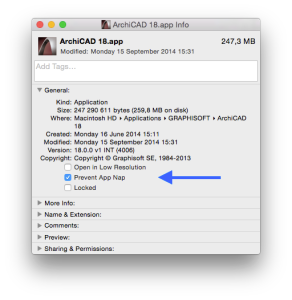

App Nap
Affected versions: 18, 17, 16 and older | Severity: workaround applicable
App nap is a great  feature to help to save battery life. When this feature gets enabled, applications that run in the background will be slowed down. There are situations when ARCHICAD works in the background (e.g. drawing update) and you would like to run it on full speed. Workaround: To keep ARCHICAD alive in the background; disable App nap for the ARCHICAD.app. This is highly recommended for all Teamwork (BIMcloud, BIM Server) users.
  • search for the ARCHICAD applications in Finder: ApplicationsGRAPHISOFTARCHICAD <version>ARCHICAD.app
  • select the app an pull up the context menu, by right click or ctrl click
  • select Get Info
  • check Prevent App Nap checkbox
App nap should be turned off for BIM Server Manager and BIM Server Control Center (applications in the BIM Server folder) because App nap might prevent the server to run smoothly. v18 BIM Server and BIMcloud is not affected.
