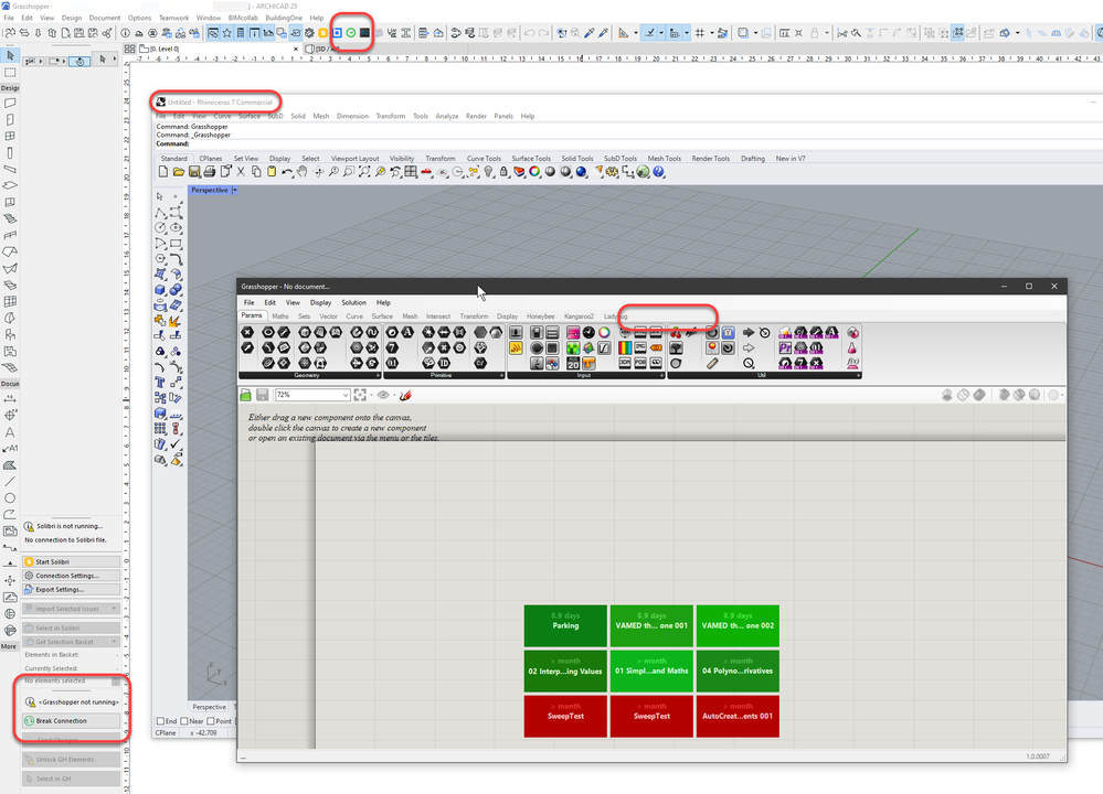

hi all,
I have installed and running: Archicad 25, Rhino7, Grasshopper, Archicad Grasshopper Connection BUT
I dont see that Archicad tab in Grasshopper:
Any idea what I could have missed?
Thanks!
BR, Florian
Archicad Grasshopper - AC tab missing in GH - 001.pngArchicad Grasshopper - AC tab missing in GH - 002.png
AC25, BIMCloud, Windows
1 Solution

Hello,
Thank you very much for the report!
At the moment, there are 2 different packages for the Grasshopper connection: one is for Rhino 5 & 6, the other is for Rhino 6 & 7. I'm wondering if you installed the correct addon? If not, please uninstall the old one and download the correct installer from here (the one with sub text: Supports Rhino 6 and Rhino 7)
If it doesn't work, if you open the location: C:\Program Files\Rhino 7\Plug-ins\Grasshopper, do you see the file ArchiCADConnection.gha there?
Best regards,
Minh

Florian99
only one is installed - double checked

Florian99
hi,
no
thanks!
BR, Florian

Minh Nguyen
Graphisoft Alumni
Graphisoft Alumni
Hello,
Thanks for the info! Have you tried reinstalling using the package mentioned in the link above?

Florian99
restart - reinstall solved the issue!
Thanks!
BR, Florian

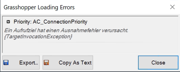

Ambrus
Hello,
I also don't see the Archicad tab in Grasshopper, and I got an error message when opening GH (see image attached).
I have Rhino 6, Archicad 26 4022 AUT FULL, and Grasshopper-Archicad 26 Live Connection (Rhino 6 and Rhino 7) from Oct. 28, 2022
I checked and the ArchicadConnection.gha is there in the Grasshopper folder.
Also already restarted all 3 programs and Windows, and the problem still persists.
Any help is appreciated, thank you.
