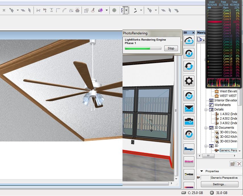

I am a system integrator that makes cad systems for Engineers and Architects that use Archicad and CAD software packages. One of my client uses Archicad. He bought a Amd Opteron 24 Core / 40GB memory system for his business. He has called me since to figure out why other multi-core supported software works faster than Archicad. After checking all the windows settings and running all benchmarks, we found out that although there are 24 cores, Archicad only uses 1 core at a time during the rendering process. During any design process the system does not lag or stutter.
See attached photograph.
I would like to know if there is a way to have ArchiCAD use all 24 cores during rendering?
There are posts (usually by Dwight) addressing the settings needed for multicore use of Lightworks in ArchiCAD. As I recall, one must not select 'best' for antialiasing/etc. I haven't rendered within AC itself for years, so can't remember for sure.
If your client really wants zippy renderings that use all 24 cores, he/she should look at Artlantis. You can download a 30 day trial from artlantis.com to evaluate. It interfaces well with ArchiCAD, is easier/faster to use than attempting to set up a render within ArchiCAD, and gives better quality in less time.

Just out of curiousity: does Lightworks Rendering use all 24 cores if you set Antialiasing a notch below Best in the PhotoRendering Settings Dialog?
Maybe you could attach a screenshot?
Hello,
Lightworks engine with best antialiasing setting uses 1/24 core at a time. See original post. However, Artlantis uses all 24/24 cores at the same time.
I also noticed that Lightworks/Archicad never runs at the full speed of the processor 2600 Mhz.

What I said is set the Antialiasing to ONE NOTCH BELOW Best.
So it should be in the second poistion from right, not the rightmost position.
Many reports have been made by ArchiTalkers about this limitation that with the Best setting for Antialiasing Lightworks only uses one core.
