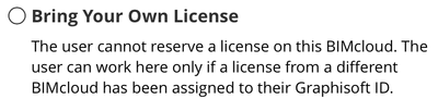

The first is the "Bring Your Own License" option shown when configuring a guest user, which states:
"The user can work here only if a license from a different BIMcloud has been assigned to their Graphisoft ID."

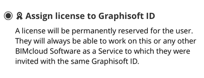

The second, and arguably more serious, is the Assign license to Graphisoft ID option shown in our own BIMcloud Manager, which states "A license will be permanently reserved for the user. They will always be able to work on this or any other BIMcloud Software as a Service to which they were invited with the same Graphisoft ID."
That phrase "any other BIMcloud Software as a Service" is, based on our direct experience and Graphisoft's own support response, simply not true. It does not work across BIMcloud instances running different license infrastructures. We followed exactly the workflow this UI describes, and were still blocked from accessing our client's BIMcloud.
There is no asterisk, no caveat, no small print. The product explicitly tells administrators that assigning a license to a Graphisoft ID will enable access to any BIMcloud SaaS. This is incorrect, and administrators making licensing decisions are doing so based on false information.

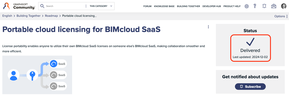

Apparently the feature to bring your BIMcloud SAAS license is considered to have been "delivered" by the development team... 🙄
