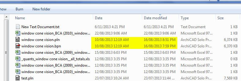

My job files date stamp has changed - very peculiar!
I have noticed that when going to my job folder my recently saved
jobs have dates from like 10 +/- days ago. It's now March so a Job I saved
yesterday should have 3/2/2014. I saved the file under another name and now it is showing correctly, But the same job under the previous name still
shows 2/23/2014.

Makes me crazy when sometheng like this happens. I thought it was impossible for a time stamp to change - NOTE: I noteced that when
the erronious time stamped job is being opened it does show the correct
date under the last modified line.

Check that your Windows Explorer is set to show the 'Modified Date' and not just the 'Date'.
Most often they seem to be the same but they can be different.
Just right click in the headings to choose what you want.
