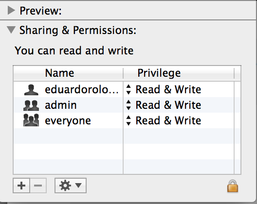

Eduardo Rolon
select the folder and use "Command+i" and edit the permissions so that you can read and write. Check in the gear icon and select apply to all.

Hi - many thanks. That has done the trick!
They had said Read & Write previously, but applying it to the whole folder was what solved it. Thank you!
