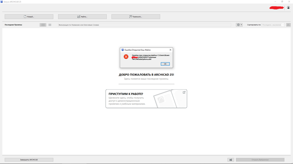

Everything used to work, but when the lights were turned off when the program was turned on She began to give an error
Help please

Could you please translate what that error message says?

Yes, I understand a power outage might have caused the problem, but what does the error message say.
I have no way to translate it as it is an image and not text that I can copy and paste into a translator.
Is it something about corrupt preference files?

Google:
Error opening cache file.
Error opening file: C\Users\...
I should have read the entire path of the error message and then I could see that it is to do with 'TWDataOption.xml'.
I would try just finding and deleting that file.
Hopefully it will just be re-created when Archicad is started again.
Otherwise maybe it will require a re-install of Archicad choosing the re-pair option.
Youn
no need to reinstall. you just have to delete this problematic file then restart the program
