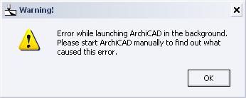

Having brand new problem with Plotmaker updating
It won't do it.
An error message pops up saying Error while Launching ArchiCAD in the Background. Except ArchiCAD can manually opens the pln file flawlessly, with no problems at all. I am thus guessing ArchCAD did NOT cause the error
Have tried updating with ArchiCAD already open, but that does not make any difference
Have uninstalled & reinstalled ArchiCAD & plotmaker & applied latest update patch - no change
THere is no change in the behavior of Plotmaker or ArchiCAD in themselves - but Plotmaker can no longer successfully invoke ArchiCAD
Presumably not a registry corruption problem, as ArchiCAD was reinstalled
Any ideas / clues out there?
{EDIT}
Problem solved - will leave this as a handy hint for others though...
Ensure that under services in Administrative tools, that you don't turn off too many default services involving database functionality or communication !

Just out of interest, which services was it that were causing this?
Josh Osborne - Central Innovation
Mac Mini
Paul King
Mentor
Hi - can't remember now - something impacting on database exchanges & detection anyway. If keen you could work out by trial & error
Possibly "Windows Management Instrumentation" ?
I had used some performance tweaks from some site or other & they advised that the services I switched off were seldom needed in practise (probably true for most people)
