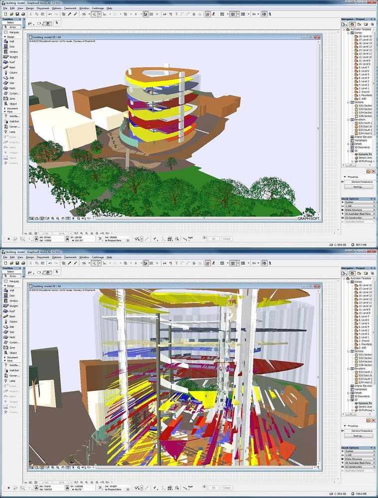

Firstly I apologise if I am in the wrong section. My Wife who is studying architecture at uni is having a problem with Archicad.
I am not an architect so hopefully I make some sort of sense. When she is looking at her building in 3D it is fine until she zooms in and it all then breaks up. I have attached an image with zoom and unzoomed.
I have only tried upgrading the drivers to the latest from Nvidia.

Hrm seems the graphics card was crap. Bought a ASUS ATI 4870X2 makes her archicad run much faster and doesn't crap out like the 260.
