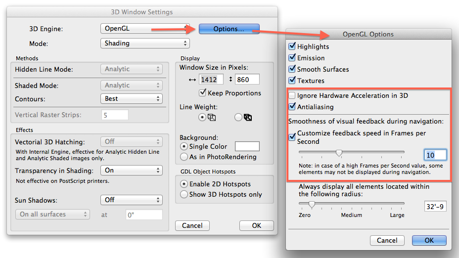

My ArchiCAD 14 freezes so frequently that it's making me waste a lot of time.
My system is a Dell Inspiron N5010, equipped with an Intel (R) Premium (R) CPU P6200 @ 2.13GHz. It has an installed RAM of 3.00 GB and uses Windows 7 Basic, 64 bits operating system. The hard disk has 182 GB free out of a total of 283 GB.
Only thing I don't know is what kind of graphics card it has. It doesn't say on the PC's system properties page and I haven't been able to find out from Dell either.
But I guess many of you also use the Dell Inspiron N5010 laptop because it is very popular, so you might be able to tell me what graphics card it brings by default.
What are the possible causes of all the freezes and what solutions do you recommend?

From what I found in searching, your laptop does not have a dedicated graphics card, but uses an on-board Intel HD Graphics chip with shared memory (it takes some of your 3 GB main memory - perhaps an amount you can adjust in the BIOS).
This type of graphics functionality is great for desktop apps, but is generally insufficient for 3D CAD.
Have you tried disabling all graphics acceleration? That would involve 2D acceleration in your Work Environment as well as 3D acceleration in the 3D window (OpenGL Options button there, as I remember - not sure). Also, making your 3D window smaller.
Freezing that is temporary could be a swapping issue - too many programs running for the amount of memory you have, or a very large AC file. When AC seems to freeze, to you hear (or see if there is an activity light) a lot of disk activity? See this article:

Karl Ottenstein
Moderator Emeritus
If the freezing happens when you are in the 3D window, then you can get to the 3D window settings by right-clicking a blank area of the 3D window and you'll see the attached dialog.
Assuming you're in OpenGL mode... click the Options button to see the OpenGL Options dialog shown. Consider turning off antialiasing and lowering frames per second. If things still freeze, try unchecking some of the other options (which will result in a less useful 3D view) just to see if the freezing stops...
See B1 at the bottom of this page:
http://www.archicadwiki.com/HowToControl3DPerformance
Just guessing...but none of this will hurt... you can always restore the original settings. If it doesn't help...maybe someone else has some ideas...

Thanks again for your feedback, Karl.
Just to update you and everyone else following this thread:
a) As you had indicated, the Dell Inspiron laptop came with an integrated graphics system that cannot be changed.
b) However, it allowed for the RAM memory to be increased. The factory-installed 3 GB consisted of two cards, one with 2GB and the other with 1GB. There are only two slots, so I had the 1GB card removed and installed a new 4GB card instead, for a total of 6GB, which means I doubled the original RAM memory.
c) I immediately noticed a considerable increase in booting and closing speed, and faster performance of all applications. As for ArchiCAD, I noticed it worked faster and did not freeze as often and did not produce errors like "ghost" drawings which seem to be so common. However, this was on a residential project. I am now working on a land subdivision in 2D and as I progress, it's beginning to freeze more often and to generate "ghost" drawings. I have had to restart ArchiCAD for it to return to normal. In the bottom right corner it shows 4 GB of free RAM memory.
Why this would happen on a simple 2D subdivision where I have used only the line tool and does not happen on a BIM house project where I have used almost every tool beats me. If anyone has an explanation, I'd like to hear it.
I have yet to experiment with the computer's graphic options, as you suggested Karl. If it improves performance, I will report it here. Otherwise, I guess I have no other choice but to wait till I am ready to buy a new computer and when I am, to make doubly sure that it meets or exceeds the minimum hardware/software requirements.
