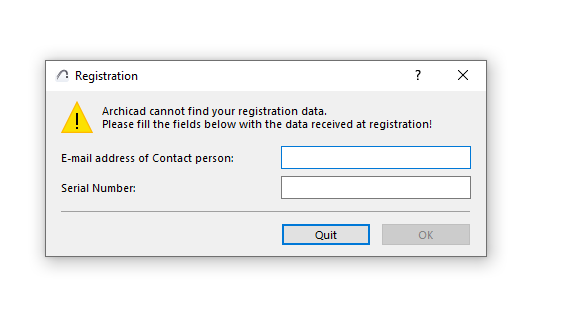

I receive this message when i try to log into AC27. My license manager tool says AC 27 has been registered and all is ok.

What is the build number of this Archicad 27? Anything release after Technology Preview shouldn't have this dialog. I suspect it's a Technology Preview version, this is why it can't recognise your license.
