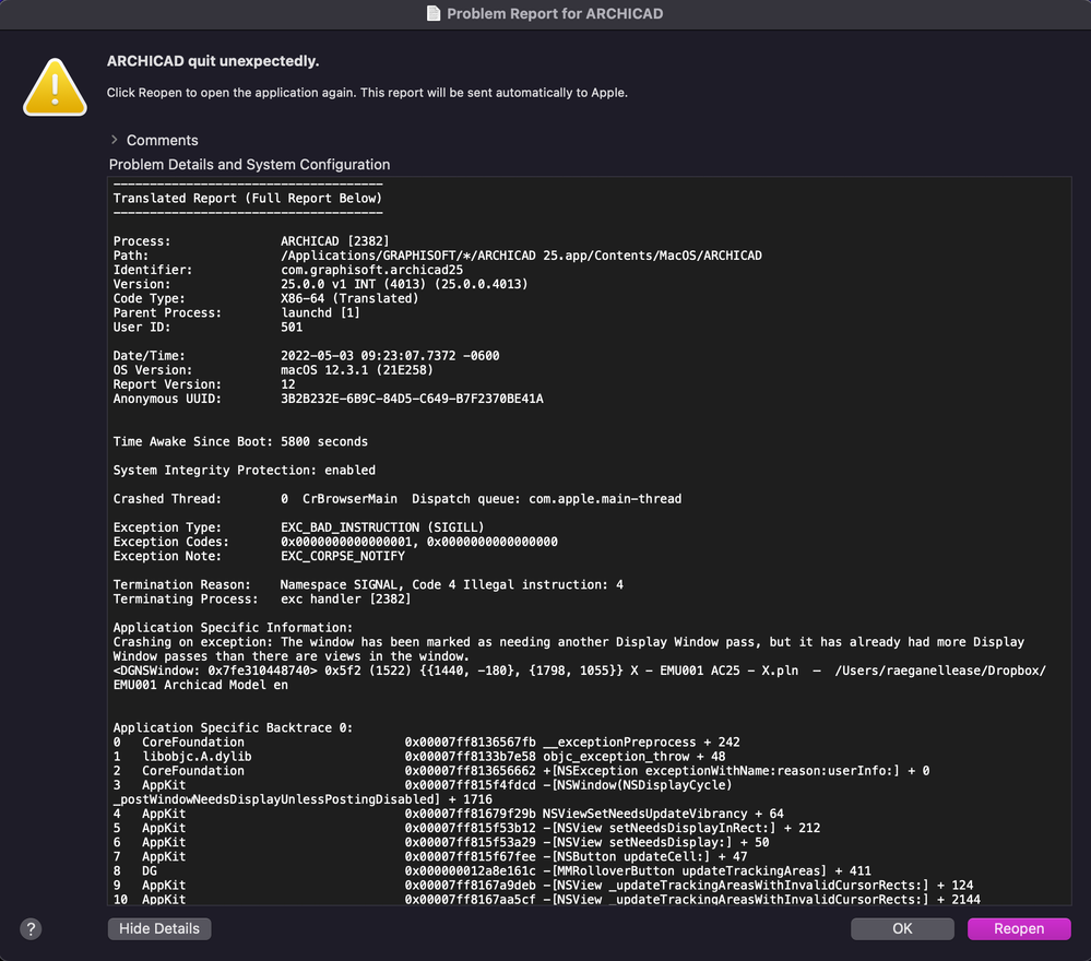

I am experiencing the attached crashing error repeatedly on a Macbook with Monterey OS and a fully update Archicad 25.

Based on the screenshot, I could see that the crash happened with Archicad 25 4013, which is not the latest update. I would like to make sure that the crash persists after updating to the latest build 5010.

I have updated AC25 to the latest version and have not experienced this issue again. Thank you!
