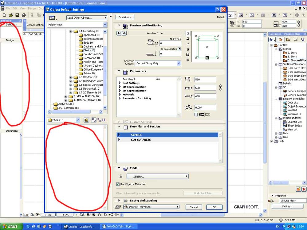

!Restored: Problem in ArchiCAD 10-need help as soon as posible
I installed Archicad10, but it is not working right. I can not see library parts in window, Tool box is empty...
Does someone know what is the problem?

I suggest you contact your dealer/supplier, they should either be able to help you themselves, or will refer your problem to Graphisoft HQ. I have never come across the problem myself.
Also check that you are using the latest build of ArchiCAD, which you can do so from the help menu.
I have seen it.....because I had exactly the same thing
And my only fix was to repair WINDOWS
This totally fixed the problem
Basically insert your windows disc in and let it repair your installation
Once done it will all be there
Let me know how you go

I think this is a low memory thing.
How much RAM do you have? The Min is 1 gig.

My thought was my Radeon 128 card but as soon as I repaired windows ...voila all was good - and has been ever since

I had exactly the same thing on 8 of the computers in our office.
GS said that it was a memory issue, so we upgraded them all to 2 Gb of RAM, but this made no difference. I also tried a bunch of other stuff like new graphics drivers, updating Quicktime etc.. Then, as a wild stab in the dark, i installed SP2 on one of them and Archicad worked perfectly. I then went around and installed it on all the reast and they are now all working.
Might be worth a shot?

Run all the Windows updates, and all should be well.
There is a thread on the same problem by Eric Batte, and the fix was to update Windows. Keep your Autoupdate on ...

I had the same problem on my laptop, and it was easily soved by unloading the AC.lfc file, and loading the AC10 library folder.
as in http://archicad-talk.graphisoft.com/viewtopic.php?t=11544
