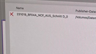

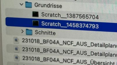

We have 2 new MAC Studios (M1 & M2 Max) and i installed the Apple optimized version with the latest final patch (first time no Intel) and OS is Ventura & Somona each.
Before Scratch files never got created, now they get created and making problem with publish and model files.
I don't know how to solve or disable it, as it's the first time we see them.
Attached some relevant screenshot from this situation (publish).
Please for an solution, thanks a lot!

Already tried:
- Contacted ANull support and had remote maintenance (works locally, not on the network drive, i.e. they wipe themselves off)
- The highest full control rights for users have been created on the newly created publishing target directory on the file server
- MacOS 13.6 and MacOS 14.x tried
- Correct version of ArchiCad Apple Silicon is installed (but my colleague reported that it was also the same with the Intel version on the Apple chip)
- Local directory selected (works and is a complicated workaround in the meantime)
- Tried to integrate network drive via AFP and SMB protocol (no difference)
