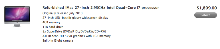

...or this one, posted at the moment in the refurbished machine list at store.apple.com - $300 off list price. An amazing amount of power and display for the money. And, at $400 more than the one you were originally looking at, a better long-term buy I think.
(If you end up needing more than 4GB memory, it is easy to do - two screws.)
If you haven't bought Apple refurbished before, the items I've seen (27" iMac and 24" LED monitor) have nothing that suggests they were ever opened or used and have full warranty.
Inventory changes daily / hourly.

PS Yes, Artlantis Studio is a big, big change and improvement from 4.5. Besides all of the new rendering/light features and ease of use, Studio 3 will use a full 8 threads on the iMac above nearly equalling my Mac Pro in speed. 4.5 not only used a single thread, it did so inefficiently causing a lot of heat and fast running fans. Which isn't to say that a bit of heat doesn't blow out the top vent of the iMac.
PPS If you want an extended warranty, you can buy AppleCare at greatly discounted prices (compared to Apple Store) from other online retailers. Use Google Shopping to check.
