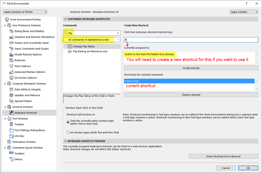

You can change your shortcuts in the Work Environment.
Be sure to use "All commands in alphabetical order' a then just search for a key word.
You may find yourself chasing around in circles, because the shortcut you want to use will be used for something else.
So you will need to fix that shortcut as well if you want to have one.
And what you choose for that may be used for something else......

Options - work environment - Keyboard Shortcuts.
You can search for "Fill" there and assign F for it and then P for mirroring.
