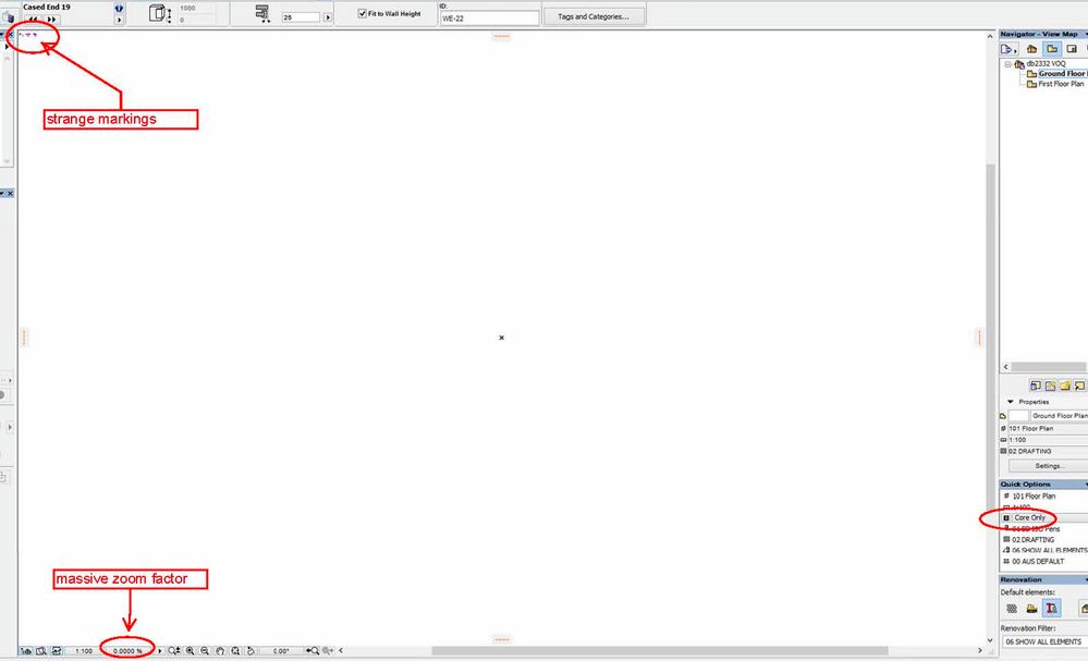

I've added some wall ends in a AC19 project & when switching between views with different partial display options, the view is zooming that far out that i get a 0.0000% zoom and there are some 'unselectable' markings in my working area. Once i select entire model partial display and fit in window, it is back to normal - any ideas?

Looks like you have discovered the mysterious extra non-selectable nodes as well.
http://archicad-talk.graphisoft.com/viewtopic.php?t=50310
I have no idea why your plan is zooming to 0% when changing views unless it is to do with the view settings.
Try changing the 'Zooming' option so it is not set to 'Fit in Window'.
It is odd because if you manually click the 'Fit in Window' button it does not zoom out to 0% - you have to manually scroll out to get that.

Looks the same as that, although it only happens when i change the partial view to anything but 'Entire Model'. Once i switch to entire model and fit in window, there are no issues.
