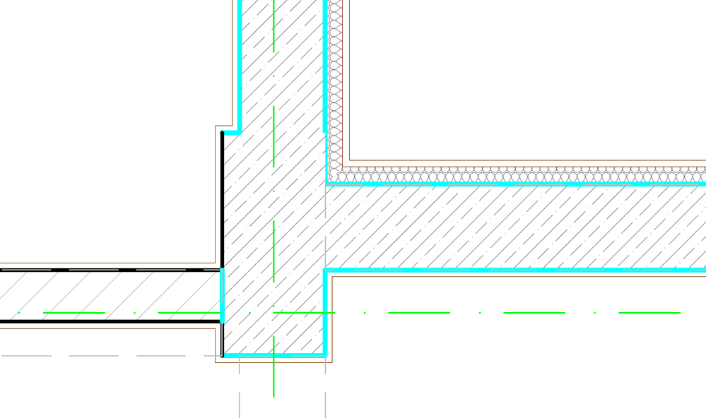

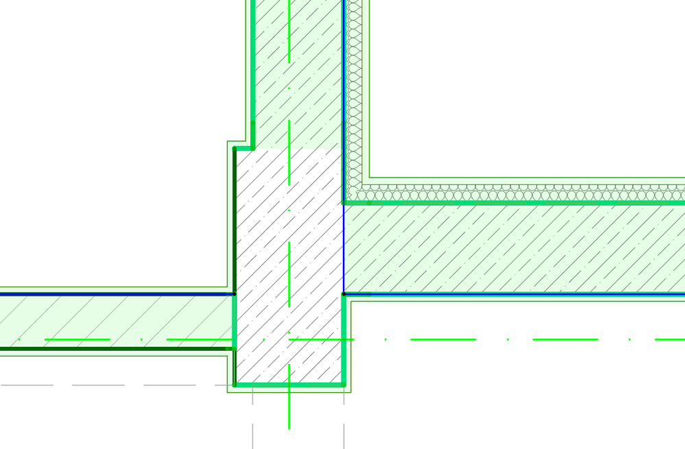

I am experiencing a corner junction issue in Archicad between composite walls and a regular concrete column.
Two composite walls meet at 90°, and there is a standard (non-profiled) concrete column at the corner.
In 3D, the intersection looks completely correct. However, in the 2D floor plan, the wall finish layers do not cleanly connect at the corner and the junction appears broken.
What I have checked so far:
  • Walls are composite.
  • Column is a simple concrete column (not a complex profile).
  • All elements have the same Junction Order value (8).
  • Building Material Intersection Priorities are set correctly (brick lower than concrete).
  • Partial Structure Display is set to full structure.
  • No visible Solid Element Operations affecting the wall or column.
  • The same detail exists at another corner in the project and works correctly there.
Does anyone know what could cause this 2D-only cleanup issue?
Are there any additional settings that could affect finish layer cleanup in plan view?
Thanks in advance.
1 Reply 1
What if you move the Reference Line of the left Wall to the lower face of its Core, and make sure the left wall and the vertical wall are properly intersected. Will that make any difference?
Also, what if you bring forward the Column in the Display Order? Does that change how the boundary of the Column Core is displayed?
