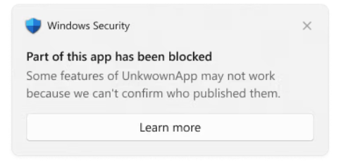

I also got the same issue of the "Smart App Control" error notification with my Archicad 27, 28 & 29, on my recently upgraded PC built in August '25 (CPU: 13th Gen i3-13100F, 48GB RAM, OS: Windows 11 Pro 24H2 build 26100.7628, Graphics: AMD Radeon RX 6500XT 4GB). All my Archicad's was working fine in December '25 and this PC was off until a week ago when I started it up again. So starting Archicad, I got this Windows notification: "Part of this app has been blocked". I also read Microsoft's "Smart App Control Frequently Asked Questions".
Apparently this came through & was automatically enabled by a recent dreaded Windows Update.
Here is some references I found to understand what is happening & what the cause is to hopefully find a fix to make Archicad 27, 28 & 29 run as usual again:
  1. In this YouTube video, the presenter confirmed this error notification, but warned that turning "Smart App Control" OFF is not recommended and can not be switched back on. For him he had to redo a clean install of Windows 11.
  2. In this YouTube video, the presenter also complained about this error notification, but he chose to turn "Smart App Control" OFF and he was happy that his computer performed better as it was before Microsoft turned this feature on FOR him, like they did for us too.
  3. (but this may be the best fix) In this YouTube video, the presenter showed an easy way to turn "Smart App Control" OFF and ON again without issues, by a setting in the Registry Editor.
I took the chance following the method in the 3rd video and could turn "Smart App Control" OFF and ON again without issues. Even after rebooting on both options, Windows did not switch it in my case. You may have to check it as it might be different on your PC & OS version though.

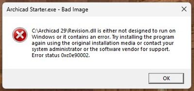

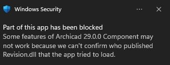

I’m also having problems with (I assume) Windows 11 and Smart App Control.
ArchiCAD 29 can sometimes take up to two minutes just to display the opening splash screen. Then I get these notifications:
Typically if I close the program and try again and it will open normally without the notifications, though there’s no knowing if Windows is still blocking something. The odd thing is that the “Part of this App has been blocked” notice sometimes flags different components. It’s not always the same thing.
Internet talk says that a future Windows 11 update will give us the ability to temporarily turn Smart App Control off and on as needed. That’s not an ideal solution, just an admission that the problem exists.
