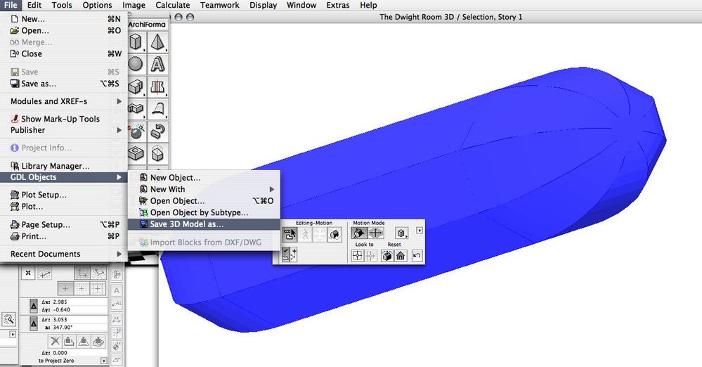

Dwight
Isee that you remain on 8.1, but a similar approach to this will work:
Saving the object from the 3D window.
the attached shows how in 9.0 - similar in 8.1

Dwight,
The 'save' feature of ArchiForma 2.0 is more powerful than saving from the 3D window. It automatically creates parameters for the object as well as a preview image. But, you're right, at least Jonathan could save something while he figures this issue out.
Sorry I wasn't more help.
