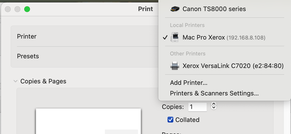

I have come across an issue where it is not possible to select a page size under print settings for a specific printer. Only 'Any Printer' is displayed even though printers are installed. I have reported this to support. It affects both Archicad 27 and 28.

Same issue - in Page Setup on MS Word, Apple Pages, Adobe Acrobat, under Page Setup only 'Any Printer' is now selectable since the Sequoia 'upgrade. If I chose Print however, both my printers are listed and are accessible.

Hi @Derek Williams,
That’s interesting to read. I don’t get that issue in Preview. I haven’t checked other apps yet.
Lee Hankins
ArchiCAD 4.5 - Archicad 28 Apple Silicon 27.3 | 28 Apple Silicon
macOS Sequoia (15.1.1)
Hi @Lee Hankins,
Only some apps have the Page Setup dialog, and from what I just checked, Preview is not one of them. Are you sure you didn't check the Print dialog (which works fine in Archicad too)?

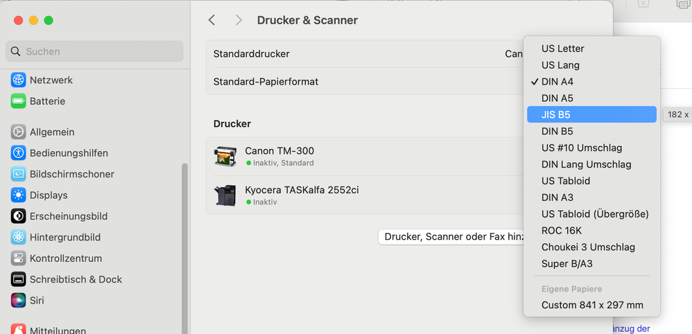

bmatt
same issue here after installing macOS 15.0 Sequoia. Since then -no matter which application or in system-settings- the pagesize cannot be chosen larger than A3 (i.e. from Kyocera).
But we need A2 - A0 using with the canon imageprograf as well as formerly under macOS Sonoma. Uninstalling an re-installing the printers didn´t help anyway.
