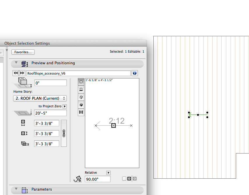

Is anyone using this in version 17? I am new to archicad and very surprised this feature is not in the software innately.
I have installed the add-on, but the slope text does not display. The strange thing is it correctly displays when I go to the object selection settings (i.e. I see 2:12 or the correct slope), but on the plans only the arrow shows up.
Works for me (haven't used it forever).
Just a guess… but what happens if you select it and:
Edit> Display order> Bring to Front
..maybe try changing the text pen?
Marc Corney, Architect
Red Canoe Architecture, P. A.
Strange. Tried those fixes, got nothing.
Do you access the object via
Design > Design Tools > Accessory
or Design > Design Extras > Accessories ??
I am doing the latter.
Yep, the same.
Maybe test it on a different roof?
One without a cover fill?
