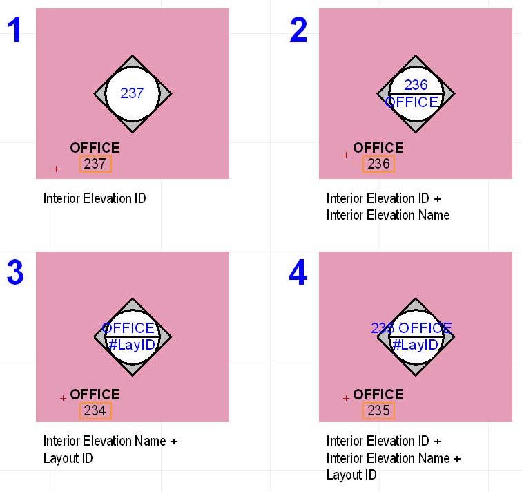

More Observations (still with the IE Markers as provided with AC11 -- I managed to create my own Marker object (fairly easily) by customizing this one `Interior Elevation 1 11`-- and still regarding the "One Common Marker..." option):
The "Inner Text" will display as either one entity or two entities ("First Row" and "Second Row"), depending on what (and how many) text parameters are turned on.

Laura Yanoviak
Note that if you have all 3 text parameters turned on, the first 2 are combined on the "First Row":

Laura Yanoviak
The last 3 AutoText options do not seem to affect the "Inner Text" settings -- they only affect "Individually..." placed Markers and the individual Viewpoint names within the Project Map.
