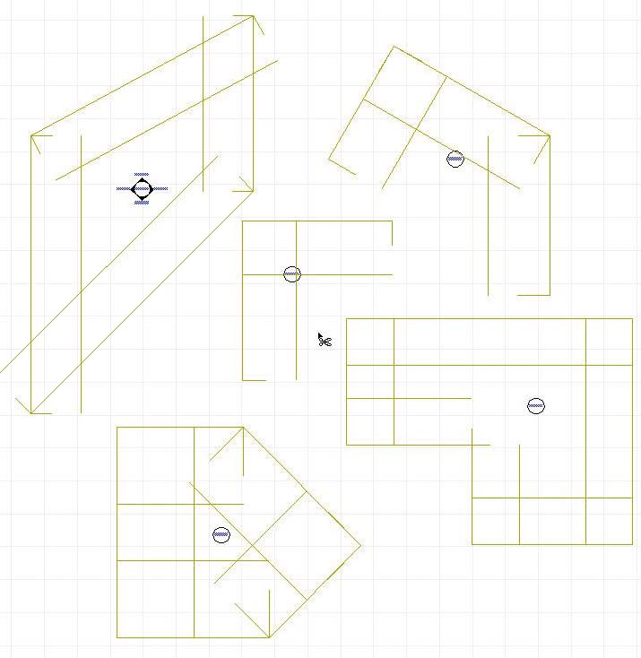

Another issue, still with the IE Markers as provided with AC11:
When grouping less than 4 (or more than 4) elevations with a single marker, the arrows from the marker head disappear!

Yeah, I noticed that. According to Tech Support, they could not find a good way to make a single marker with off-orthogonal views.
Tom Waltz

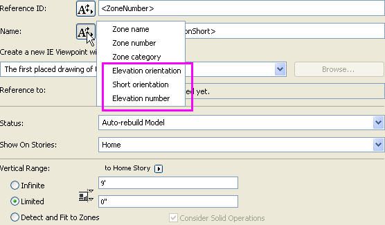

More Observations (still with the IE Markers as provided with AC11 -- I managed to create my own Marker object (fairly easily) by customizing this one `Interior Elevation 1 11`-- and still regarding the "One Common Marker..." option):
The "Inner Text" will display as either one entity or two entities ("First Row" and "Second Row"), depending on what (and how many) text parameters are turned on.

Note that if you have all 3 text parameters turned on, the first 2 are combined on the "First Row":

The last 3 AutoText options do not seem to affect the "Inner Text" settings -- they only affect "Individually..." placed Markers and the individual Viewpoint names within the Project Map.
