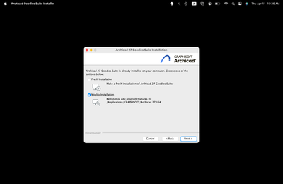

Hi Karl/team.
You need to close all AC programs & rerun the Goodies installer.
Then choose the repair/modify option :

Hi Karl/team.

‎2024-04-11 09:12 AM
Thank you Toper! Reinstalling Accessories solved it. But if this repair process has to be performed everytime Archicad is updated it is definately a bug. I hope GS will deal with it. I will send a mail to my local Archicad support to make sure it reaches Graphisoft.
