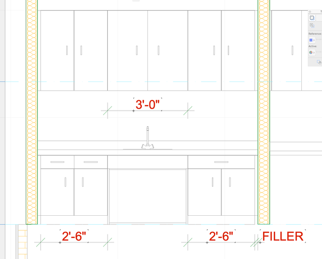

Hello! I have been working on a cabinet favorite for our office template for Archicad 27. I would like to create a base cabinet that has double doors in segment 1 with a drawer above each door in segment 2. Past cabinet objects let me choose 2 drawers, but I can't seem to find where I can change from 1 to 2 under segment details, segment 2. The 1 is grayed out. Any help would be greatly appreciated. Thank you!

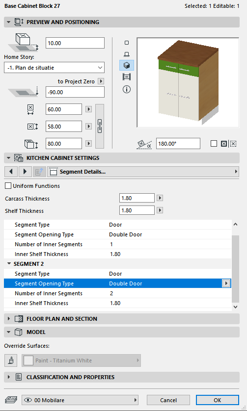

I have checked - so the way I see it, Archicad understands segment as a horizontal separation. As such, the top drawer would be split horizontally. For illustration purposes, a open type segment with 2 inner segments. A closed drawer would not be split horizontally, and that's why the option is missing
A possible workaround to achieve your desired result would be to use a double door on segment 2 (which would represent the drawers in elevation view).
If you were to section this, you wouldn't see them as drawers though, and if this would be a deal-breaker, maybe having two identical 1/2 sized cabinets would be the way to go (as in, instead of one wide one, make it out of 2 halves).

Thank you, Barry. I hope they do bring back the no. of drawers option. I could still use an older object, but I'm trying to use as many of the AC27 objects as possible. I have heard that newer versions will be dropping the version number from the object name, so I'm trying to keep up. I did find an option that works for me and our interior elevations. If I navigate to Front Panels, choose Segment 2 to edit, and then choose vertical frames, it does give me the look I want for our interior elevations.
I have to set the frame width as just under 1/2 the size of the cabinet. This creates a vertical line dividing the drawers.
