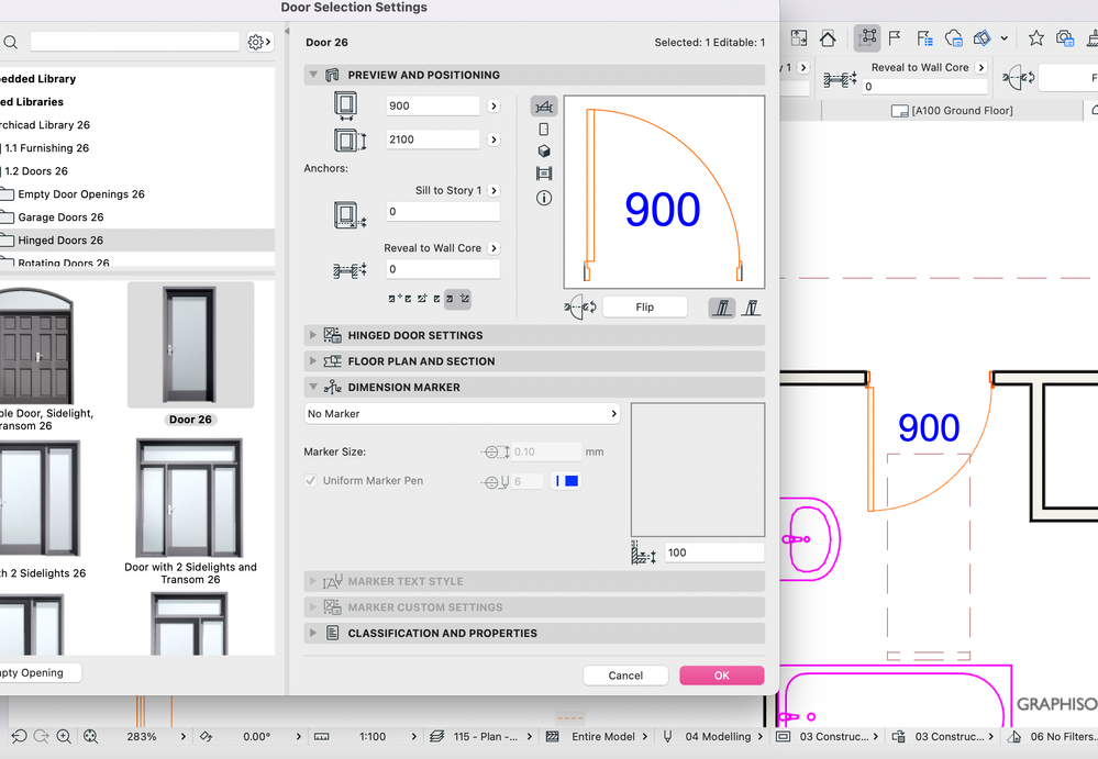

I'm trying to remove the dimension labels from these doors, however despite having the 'no marker' option selected in the door selection settings it still appears. Any help would be greatly appretiated!

That is not the door marker.
Try tags and labels.
