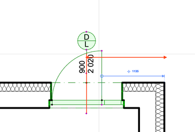

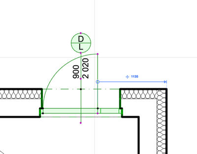

Hi, how can I change my default setting for door dimensions (distance from wall) to be set from middle and not from sites?

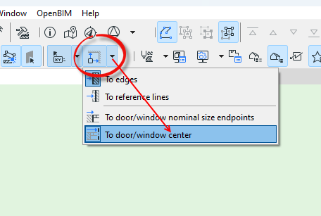

1 Solution
You can change the Distance Guides settings.
Although it may go to the centre of the door leaf rather than the centre of the overall frame.
I am not sure.
I am not sure.

Thanks, its working... Is there a way to have is set to middle for doors and edges for windows?
Not as far as I know.
You have to make the setting change yourself.
But you should be able to setup a keyboard shortcut for it in the Work Environment (I say this without having checked it myself).
