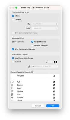

filter and cut elements in 3d can hide by tool/element type: 
