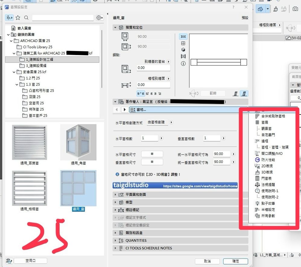

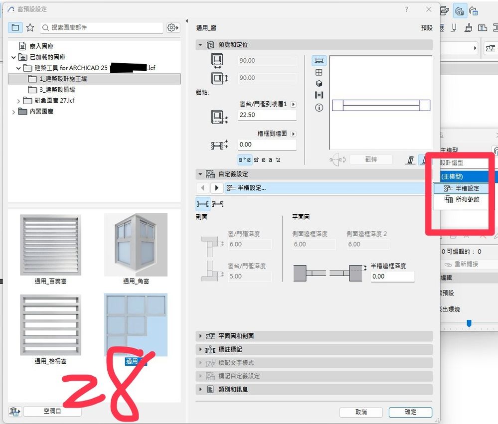

Hi, i have a lcf file it works well in archicad25
but lost a lot of  custom settings in archicad 28
is it possible to fix it?

Based on your screenshot it looks like the object is erroring. Missing macros are the most likely candidate as lingwisyer suggested. But it could be something else too.
Check the session report window to identify what is throwing the error.
