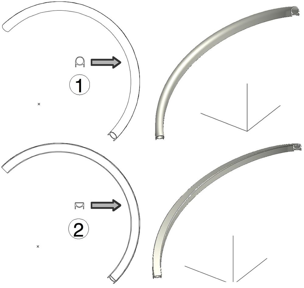

Try the OBJECTiVE add-on. You can easily create and modify profiled GDL objects (swept, extruded, etc):
  • 1) Draw a fill with the required profile and use the menu OBJECTiVE/Component/New Profile to create a new profiled object
    2) You can obtain a fill with the profile shape at any time with OBJECTiVE/Component/Extract Profile, edit the shape, and reapply it with OBJECTiVE/Component/Change Profile
Refer to the attached image. For more info, take a look at: http://www.encina.co.uk/objective.html

This Objective add on is really impressive!
It would fit my objective and a lot more. But my idea was to be able to use these profiles in my own objects, by choosing them as a parameter, and i'm not sure i can do that here.
