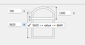

The minimum height of the Arch Top Window is half your width plus frames. If it had to be semi-circular, sure, but when it there is the option to not be, why include it. I can have a tall skinny flat arch, but I cannot have a short wide flat arch... Guess I am making a custom object... Or maybe a curtan wall...

Or, you could just find in the Parameter Script where it sets that minimum value and modify it.
Anyway, I agree that that value could be much lower, maybe even zero it it is a half circle. Probably, many parameters would have to be st to the correct values, but still, should be possible in theory.
