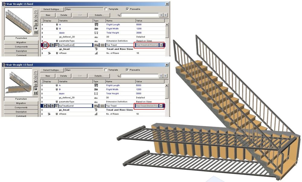

The <Straight Stair 15> stair object seems fine, but on closer inspection, there is a parameter missing in the object's settings pane, which has been switched off. See my screen shot collage for a visual synopsis.
Parameter name: topTreadLevel
With my basic knowledge of GDL I simply re-saved the stair object to my embedded project library as <Straight Stair 15 fixed> and switched the parameter on again. Simple, but alas, not a fix.
When the missing parameter is set to 'Top Tread Below Floor Level' the 3D stair displays in a very odd way (2D symbol looks fine)
I ask that Graphisoft please fix this and re-issue the v.15 library as a general update.

A coworker noticed this as well. If you create the stair, you have that option, but not if you use the simple stair tool.
I feel you should have that option with the stair tool.
