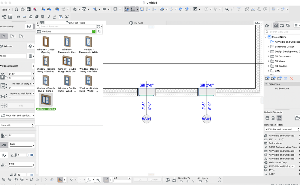

I am having trouble using favorites.
As an example, if I want to use a sliding window and choose it in my favorites, archicad will not place the selected window from favorites. It seems archicad will only place whatever window was used before. This applies to all objects I've tried from my favorites. Another example, if I wanted to place a favorite sink with cabinet but last used a toilet , archicad will not place the selected object but will continue to place the toilet last selected.
I can select without trouble different objects as long as they are not favorites. Anyone else experience this?

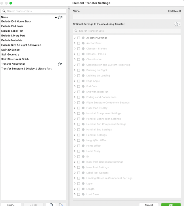

Ok, I found the problem - I had my transfer settings set to "exclude library part". Apparently, the favorites are sensitive to the transfer settings - see pic attached - all good now

You are double clicking the favourite to pick it?
Just selecting it (single click) does not apply the settings.
Robby
Thank you for the response Barry - yes indeed I double click to no avail. Please see screenshot. The slider window favorite is selected, yet the window placed is a casement.
