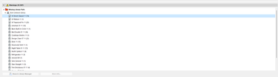

Hello!
I have an Archicad file from 2010 and it does have a lot of missing library objects which have the suffix 11. Now I am new to AC and hence do not exactly know if the missing libraries are of the 2011 AC version or what... I tried googling for them as well as searching the Graphisoft support, and download sections but of no much use. Would request that someone could help me with the link to libraries related to the below objects so I could get started with my work.

Hi Deep,
It looks like you have to add the old Migration Libraries (10 to 12) to your project. You can find them in your GRAPHISOFT folder on your PC.

It worked!!! Thanks @Nurbs
