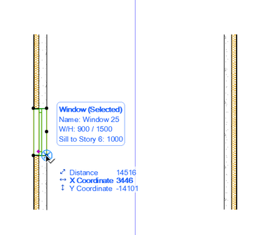

Are the windows not mirrored based on the line?
LeeJaeYoung
It is possible to use the mirror as the reference point for the wall, but why does the window have only one reference point?
AC27 on window 11
2 REPLIES 2
Windows and doors can only be mirrored within the same wall.
You can not mirror from one wall to another.
You must mirror the entire wall with the window if you want to do that.
Or copy the settings of the window (ALT+click (Pipette)) and then just place a new window in the other wall.
