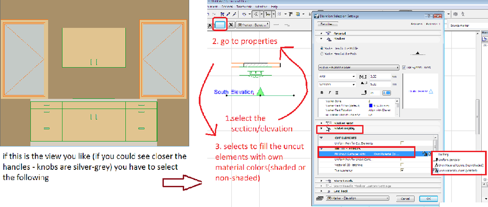

Hi, i would like to know which method is the best to draw the wardrobes and kitchen cabinets on a horizontal section (plan). I would like to have the horizontal view at different heights but i don't think it's possible.
Should I just draw it by hand? Or is there another method? I would like to have the look on the included picture. Also is there a way to differentiate in a section the different materials of a kitchen cabinet? For instance a fill for the handle, another for the counter and another for the handle?
And finally, is there a way to show the wardrobe and door handles on a plan? I can see them in section but not in the plan.

Here's one answer..

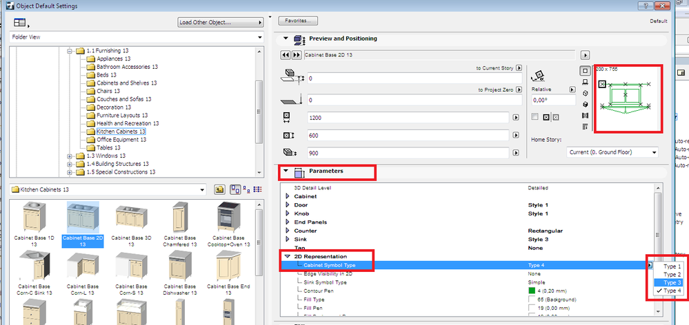

You can show actually the cabinets in floor plan, I didnt find the knobs (handles) though.
As fas as which one is the best way.. when I was a younger archicad user I was doing it with simple lines, then I explored the library a bit longer and discovered that I can do it with the 3d elements from the library
I'm sending another one for the materials u asked..

This one is for the colors and the materials in elevation views, I think its quite nice, the colors that represent its material are found in menu -> Options -> Element Attributes -> materials
Im happy to help!
Yes this one is tricky there is one option that u change the height that floor plan cuts, its on menu-> Document -> Floor plan cut plane, and in the upper right box u say at what height you want the cut to be, but its not working for the cabinets, I ve just checked
If u draw a section line and the cabinets and inside selves are shown in it, you are not happy ?
