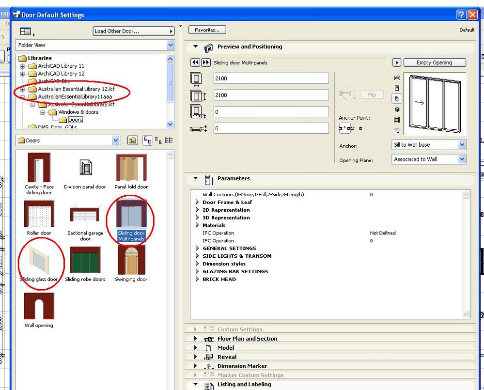

what kinda sliding door are you trying to make??
the AU essentials library have most.
theres a download in the depository also for larger stackers if thats what your after??
The sliding doors are gonna be aluminium framed glass sliding doors
do u have the AU essentials library? they have sliding doors in it alread
in both AU library 11 and 12
