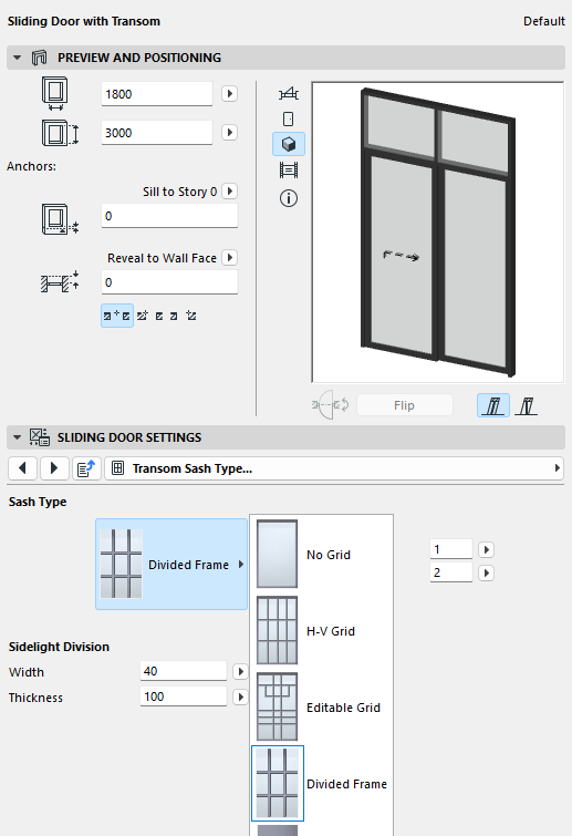

Hi there,
I would like to add a vertical mullion that splits the glazing above the sliding door. How would I do this? The name of the door I am using is "sliding door with Transom".

Friday
Thankyou. I tried the H-V Grid and that didn't work but then tried Divided Frame and that worked perfectly.
Best,
Clauds
