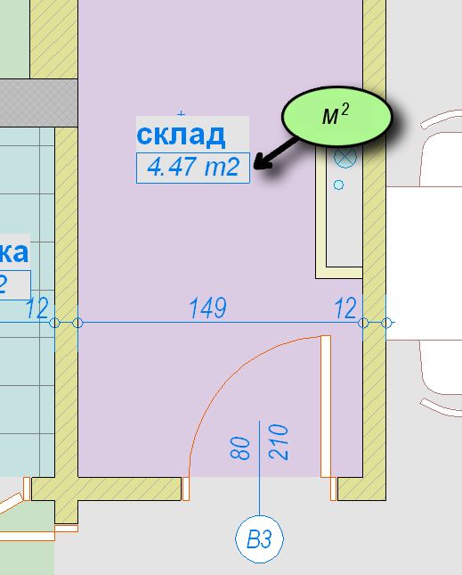

Can Zones be made to write in Superscript?
I want Zones to display room area in square meters, using the shorter version of it : m2, with "2" in superscript. I also want it to be displayed in cyrillic - small cyrillic "m" is like capital latin "M".
Zone stamp is Zone_Stamp_02 10 on AC10.
Can you share any ideas?

But I can explain it to you the GDL behind it.
So: the format in which Area Text is written out by the Zone Stamp is acquired using a REQUEST function in GDL.
Check this script from the 2D SCript of Zone_Stamp_02 11.gsm:
area_form = "" ! Format as set in the Preferences
rrr = request ("Area_dimension", "", area_form)
room_area = str (area_form, Temp_CalcArea)
gross_area = str (area_form, Temp_GrossArea)
The line starting with "rrr..." uses a REQUEST function to read what format is set in Project Preferences for Area dimensions and loads this info to the area_form variable. So area_form will contain the format of the area value. By format we mean number of characters, number of decimal places or fractions of inch, plus units of measurement, such as meters or feet-inches.
The room_area and gross_area lines create the Text strings using this format.
All the available variations that can be returned by the format tring can be found in the GDL Reference Guide in the STR command under String Functions.
You would have to check whether the unit in the format string is "m2", then take apart the string into two pieces (e.g. "12.50 m2" into "12.50m" and "2") and you would have to generate the "2" with a smaller font and a bit raised relative to the main text of the dimension.
So it can be done but it is not fast or easy or simple.
Actually it is more simple than I expected...
1. In the 2d window, insert a text box;
2. In the text box, insert the symbol that you want ( for example ³ or a cyrillic one) and select it with copyclip;
3. In the 2d script of the zone object, find the unit string definition (something like " m2", select the "2" and paste the symbol.
4. That's it!
You can do the same procedure with a custom/static area!

It worked when I tried it - thank you Paulo. I didn't use the cut-paste method but directly put in the "²" character (Alt+0178 on a Windows system. BTW, "³" is Alt+0179).
Just out of interest, Laszo, what character were you using that returned a "?"
It may be an encoding problem but there is also the possibility that the font you were using for the zone stamp simply didn't have a definition for that particular character.
When I use - say - Arial, the superscript appears correctly. However, when I use another font which doesn't have that character defined, I get a square box instead (right side of the attached image).
Hope this helps.
