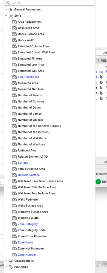

I am working with a hotel which has around 300 bathrooms.
I would like to be able to make a list of the zones containing a shower and a list of zones containing a bathtub.
Is there a possibility to write an expression; for example IF zone contains bathtub = true. Or something in that manner.
How can I write this expression?
Thank you!

Maria_K
Merci, but the problem with sorting the schedule after shower (or bathtub) is that I can't list fields that are zone specifik as 2D plan view, area, number of windows and so on.
Hi Maria_K,
It might help to mock up (e.g., in a spreadsheet or table) how you would like the schedule to appear. We may then better assist with a solution.
