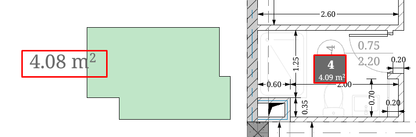

I am calculating one and the same area by Zone and Fill tool. First, I am using the fill tool and it shows me a particular area [35.79m2]. See photo:
Then I use the zone tool, I take the magic wand and fill the shape with zone but the output is different. [35.78m2]
The areas are identical because I used the magic want for zone to perfectly match the fill area. I need both of them in my project and this creates a huge danger in calculation. Could someone help?

Increase the decimal precision of your dimension units just to be sure they are exactly the same.
Kikoria

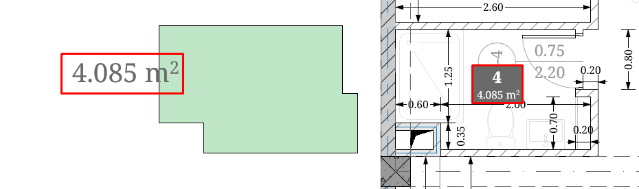

I tried it. They're identical:
but as soon as the decimal reduces, here's the result:

Seems the fill is rounding down and the zone is rounding up.
You would think they would both be the same.
What happens if you increase the decimal precision even more?
Take it all the way to 6 decimal places.
I am suspecting there is still a slight discrepancy - it may even be beyond 6 decimal places.

Kikoria
I think I found some new information about the issue. It doesn't happen always. It only happens when the rounding decimal ends on 5. So, for example, if you have 3.125 the Zone and Fill will round them in a different way. Fill would round it down and display 3.12 while Zone would round up and display 3.13.
Can this be fixed?

I don't have Archicad running at the moment, but next time I start it up, I will check it with a fill and zone that are exactly the same and ending with a last decimal of 5.
I just drew a fill 3125mm long by 1000mm
Area = 3.125m²
I magic wanded a zone onto it, so it has exactly the same area.
At 2 decimal places, they both round up to 3.13m².
So I would say there is no problem with the rounding.
But maybe your zone and fill are not exactly the same.?
