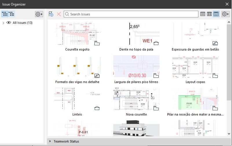

My issue organizer shows issues in Large Thumbnail View,
in Medium Thumbnail View,

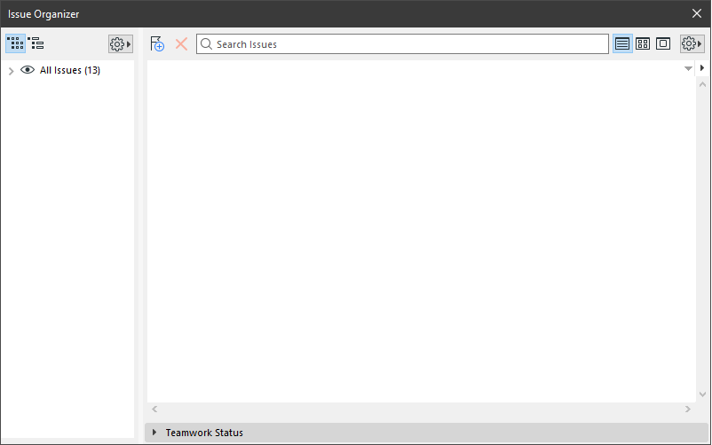

but not in List view.
I can't get to see any issue in List view.
This seems to be happening only inmy computer. Doesn't happen in other computer connected in teamwork in the same office to the same project.
Do I have any wrong configuration?
Could this be a bug?

I solved the problem by uninstalling and reinstalling Archicad.

I'm having this issue now and noticed it's happening also on my coworkers computers, within the same Teamwork project.
I really hope reinstalling isn't the only solution. Would I have to do it in all computers? 😅

I had a similar problem; title/column alignment, "Has Selected..." was missing... Astra and me are best buddies now:
Close AC, start RegEdit and navigate to:
HKEY_CURRENT_USER\SOFTWARE\GRAPHISOFT\Archicad\Archicad 27.0.0 GER R1\Dialog Manager Custom Data
There's an entry
78174A22-5C3D-48EB-B75D-0958BED24C71
which - at least on my machine - is responsible for the Issue Organizer's column structure and what not.
Delete, restart AC.
Sorry, Windows only; and I just checked; AC26, AC29 have the same key.
