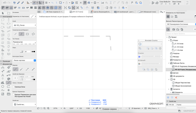

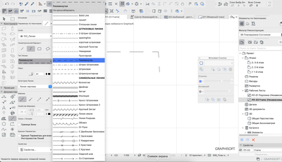

When I first tried to choose a line I couldn't do it, because only openingline was available. Then something happened and I could only draw dotted line and no other type of lines. When creating my own type of straight line I cannot choose it.
Screenshot is attached.

Are you using macOS Ventura? This is a known issue. If you update to Archicad 26 Update 2 or the latest update to Archicad 25 it will fix the issue. If you don't want to update you can use the arrow keys to select the linetypes.
Lee Hankins
ArchiCAD 4.5 - Archicad 29
macOS Tahoe (26.0)
Yes, macOS Ventura. Big thanks!!! You really help me!
