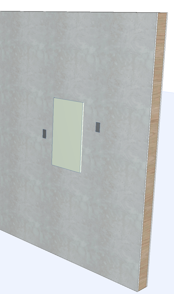

Hi Kelly,
Right. The referred object instance becomes a part of the main object, so it goes with it on its assigned layer.  (In my objects, the referred items are all considered equipment, so there is no need to separate anything.). Further, the GDL Object node does not appear to have a hook to assign another layer (wouldn't that be elegant).  I suspect the combined GDL structure only has a hook for one layer assignment.
A quick thought: As a limited alternative, you may instead add simple, reference shape nodes (e.g., electrical outlet plates) with the dimensional relationships you need to your primary object (e.g., mirror shape). These reference objects could be either 'buried' in the wall surface (relative to the main element), or clicked off after you put in your electrical boxes.  (For the visibility toggle, you add a Boolean node to the shape node Visibility setting.).  I ran a quick test which is dimensionally correct, but you cannot snap to the elements.  I believe snap nodes can be added in the GDL editor; not sure if they can be in the initial PARAMO creation.
