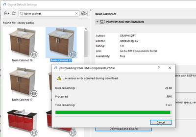

Cannot download Basin Cabinet 23
I cannot download the Basin Cabinet 23.
this option matches what we can purchase for a basic location.  The other option don't look like products for a typical restroom here in the US
It hangs the PC or just never stops finishing the last 3%

I can confirm it does not download through the object settings or by going to BIMComponents website either.
I see the object was uploaded by a Stephen Curtis rather than Graphisoft themselves.
Maybe it was not uploaded correctly.
I tried sending a message on the BIMComponents web site, but that does not seem to do anything.
Report it to your local Archicad support, but it will be quicker to download Archicad 23 if you don't have it already.
Install it and extract the 23 library LCF and then copy out that object.
